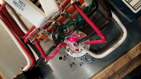

Hi all,
I finally got around to building my Crack! I'm an experienced builder, having built several amps and countless cables so far. Resistance check passed, voltage too (although see below for values), both tubes light up (both halves of the 12UA7 and the 6080 are lit). After discovering the issue, went back and checked all joints (I solder with a magnifier AND wear glasses, lol). Voltage:
1: 82
2: 167.9
3:0
4: 167.9
5: 152.5
6: 0
7: 105.9
8: 0
9: 151.8
10: 0
I'm attaching a picture of the socket in case that's helpful. Thanks in advance for any assistance! The R channel sounds great, can't wait to hear the L!  ;D

    • Posts: 20295
Can you carefully measure the voltage at A2 and A3?

    • Posts: 20295
The LED at A3 is open.  You can wire a jumper in between A8 and A3 to get up and running, or replace that LED.

    • Posts: 20295
It doesn't degrade the quality of the amp.  Trying to solder a wire to the lead of the working LED may damage that LED.
Offline Crackawaka
    • Posts: 13
That did it! Thank you for the help!! It's sounding FANTASTIC! I'm going to live with it for a couple of weeks before building the Speedball kit for it!
