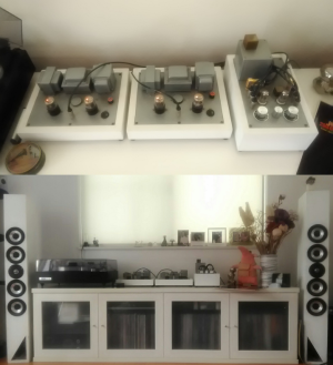

Btw, I've attached a photo of the original Foreplay and SEX monoblocks, with the Whamodynes. Th amps have been sounding great for over 20 years and only ever needed new filter caps, a couple of resistors replaced, and fresh tubes.

Wow, that is some vintage BH gear right there!
    • Posts: 9805
Reply #6 on: May 03, 2019, 05:15:45 AM
Wow, what a flashback! The dreamy soft glow and white finish on everything is kind of how my memories of the early days of Bottlehead appear in my head. Probably due to the morning after gin fog I usually had back then.

The dreamy soft glow is down to my cheap phone and its lousy camera! Nothing to do with my own considerable gin intake  ;)
