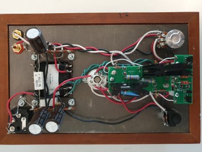

Can you post some photos of your build?  I'd be interested in seeing the power supply wiring, headphone jack wiring, and each socket.

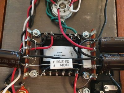

You have many, many connections in that amp that are just the stripped wire passing through a terminal with a little solder on it.  I would recommend going back and bending all those wires up against the terminals they are passing through (this is the "attach' part of the instructions), then reheat the solder joint and flow a little solder between each wire and terminal where the wire is resting against said terminal.
There are also some leads that aren't well trimmed that may cause some problems.  Specifically the area around the 220uF cap by the UF4007 diodes is concerning.  If you lay down two of the three power supply caps like we show in the manual and take new photos, I could see much more of the build under there.

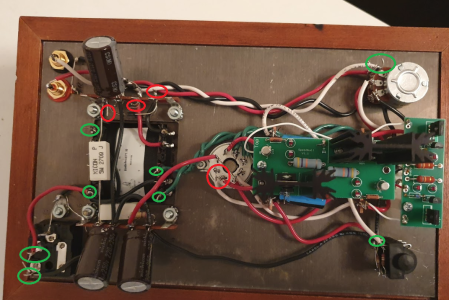

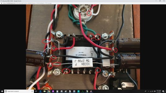

Did you want picture like this?
I added two more angles to the shared folder
Reply #11 on: May 01, 2019, 07:18:45 AM
Yeah, you need to bend the leads up against the terminal strips and then reflow the solder joints.  I've circled potential issues in that photo; I wouldn't ignore any of these.
