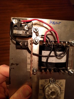

So here what it looks like now after I tried fixing it
So in that picture there is a few things...
1 - I beleive my wirrering is correct for my 123V
2 - I wasn't able to remove the solder wire from my mistake on number 14 and 17, so I opted to cut the wire (followed my electrical engineer uncle advice)
3 - when I performed the second test, the results were 0V when both clips were on. (The black and red)
4 - when I performed the second test whit ONLY the black lead on power transformer terminal 7.
The reading was ... Between 2.1 and 2.9 V
If more picture are needed I will post them
I hope this is clear, English isn't my first language, so I'm sorry for bad syntax and grammar :S

Reply #1 on: May 03, 2019, 05:12:09 AM
I would check your fuse.  Cutting those wires off when you were correcting the wiring issue won't be a problem.

Reply #2 on: May 03, 2019, 06:13:35 AM
Oh my god, I forgoted to solder 1 thing ! No wonder
Must of been tired yesterday thanks anyway
A huge thanks for the help tho, really appreciate it
