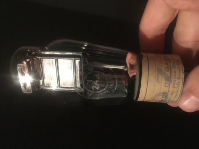

Found the weird 2A3's again. The one below is complete with it's original "bande de garantie" dating 20 June 1936!
Hopefully it will still work! :P

Those were the first 2A3s; lasted about one year before they converted to the "biplate" design. Very rare, quite valuable too!

Last week i've learned a thing or two about the monoplate.
Now i'm actually in doubt if they work well in the Stereomour.
Are these monoplates more fragile? Should changes be made to Stereomour II to use them safely?
Quote from:  Some hifihaven topic
As an aside, as much as the vintage single-plate 2A3s are heralded as the bee's knees by some folks, I have heard that some (perhaps many) modern 2A3 amplfiers operate under conditions that are too much for 'em. I got some empirical data on this when I tried one in a single Bottlehead Paramour. Oops
    • Posts: 5907
Reply #10 on: May 19, 2019, 01:02:29 PM
Stereomour, which is the same basic circuit and operating points as Paramour, runs the 2A3 at its maximum dissipation and maximum voltage. The normal biplates are quite tough, and of course the modern monoplates are mini-300Bs and most of them can handle quite a bit more power and/or voltage - at one point the Sovteks were said to be good for 23 watts dissipation.
I too have heard intimations that the original monoplate is a little fragile. I would not operate them in Stereomour if they were mine, out of caution for a rare and valuable tube. But I have no direct experience and no actual data; I don't think I've ever heard exactly what the problem is.
I can speculate that the originals were either difficult to make, or had a high rejection rate, or a high failure rate in service. There must have been some reason they were quickly replaced, after all.
One could probably operate them as if they were 45s, reducing both the plate voltage and current - but as I said, I don't know what the risks are, so I can't make any actual recommendation.

From what i've read it has to do with the heater wires easily failing and shorting the grid wires.
Anyhow. That's left me with 0 options to roll for the outputs of the Stereomour, but have many 12AT7's to try.
