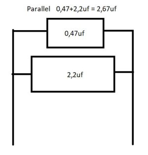

1. If I would like to add the 0,47uf to the 2.2uf to get a total of 2,67uf capacity. Would I then connect them in parallel to combine the capacity (= 2,67uf) ?
2. I have attached a picture on how I think the parallel connection should be, it would be great if someone could verify it or correct me.
3. What would be the easiest way for a beginner like me to burn in the new capacitors without using my cartridge?
Would it be possible to play  a special audio file that is made for the job just from a normal source (phone or computer),
or would I need to buy or build a inverse RIAA filter?

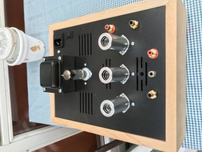

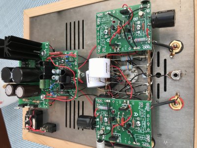

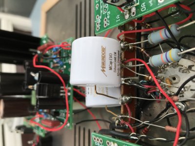

I have attached some pictures of my Eros. I still have the task waiting for me to treat the base of my Mainline and Eros.

    • Posts: 20295
Reply #8 on: May 15, 2019, 12:31:53 PM
Yes, that is how you connect capacitors in parallel, though you may not prefer the extra caps in parallel with what you have now.
