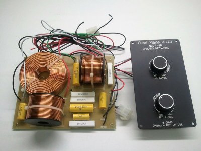

I don't have a schematic, but I know there is only one set of inputs.  My thought was that if I biamp, I would have to add a second set of inputs to the back panel of the speaker and bypass the crossover altogether.  Then use something like these active crossovers between the Beepre and the amps.
https://www.xkitz.com/collections/active-crossovers-and-bi-amplifiers-1/products/linkwitz-riley-2-way-active-crossover-fully-assembled-xover-2
a picture of the GPA crossover.  I have the N604-8b, not 8a
https://www.picclickimg.com/d/w1600/pict/332062446199_/Altec-Lansing-GPA-N604-8B-Crossover-NEW.jpg

Without a crossover schematic, it's still rather impossible to know.  Crossovers are sometimes a lot more than just book value filters, and without understanding all of what's going on with that PC board, it's very difficult to determine what you would actually need in an active crossover.  It may be that a fair amount of what's on that board has to stay even if you do end up with an active XO.
You could certainly contact GPA and ask them about biamping with that crossover.  They may even be able to make you a custom one that allows this.

I googled a bit last night and looked at several crossover circuits. They looked separable with a little rewiring. Both had equalizers for the tweeter/horn rolloff, and one or two adjustable controls - not simple or obvious.
