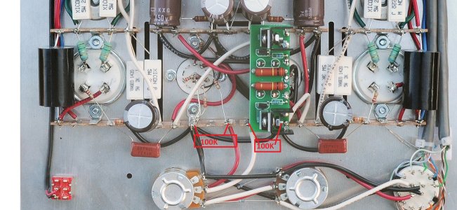

    • Posts: 20281
You can put a 50K-470K resistor from each 12AT7 to ground.  Nothing else is necessary or helpful.

    • Posts: 20281
Here is a drawing of where they go (to the terminal strips, not the C4S PC board).
I'll just throw out there that a well made and fully upgraded Stereomour II should sell used for about the price of a new kit.  If you turn it into a power amp and you have lots of empty holes in the chassis and reduced functionality, I would expect the used value to drop by about half.
Another far less destructive option would be to drill a couple of holes into the front of the wood base, then install a pair of RCA jacks on fender washers glued onto the wood.  You can wire each jack right into the terminals I've indicated on this drawing, then just leave the coarse control all the way up.  This would give you a direct pair of inputs, and if you changed your mind or wanted to sell your Stereomour, you could just purchase a new wood base and remove the extra wires.
Deke609
Many thanks PB. That's what I had in mind.

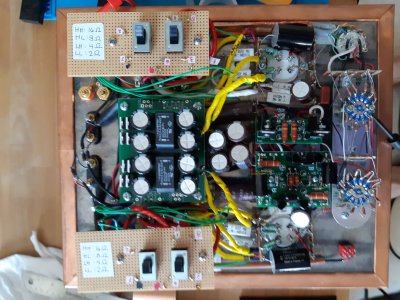

Quote
Yeah, but I think that ship has sailed already! See attached - a ton of copper braid shielding beneath electrical tape/shrink-tube and a kajillion green ground wires from the shielding, plus the impedance switch boards.
I think I can use the Mourquiet/pot holes for a single set of inputs - but I might decide on adding two new holes closer to the terminal strips to make more room for the parafeed and coupling caps.  I'm not fussed about open holes -- more ventilation!

    • Posts: 20281
Reply #11 on: February 20, 2020, 10:32:27 AM
Yes, you can wire for balanced inputs, but you'll need a pair of input transformers.
Yes, the resistors need to be there if you are removing the volume/balance pots and using one input.
