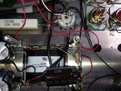

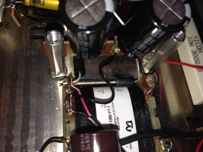

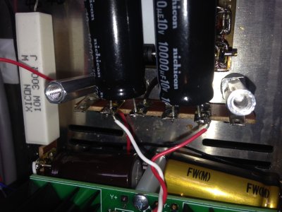

Thank you, Paul. Assumed it was prudent to sort out resistance issues before applying power! The jumper is there; all mentioned points have similar readings...well in excess of 0. Attaching photos; not sure these will be useful, but this phone camera is all i got.

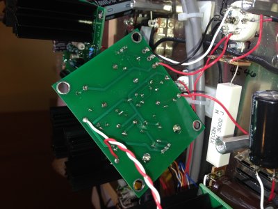

Reply #6 on: May 19, 2019, 06:42:33 AM
Two more.

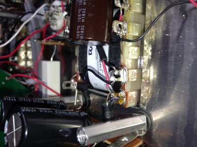

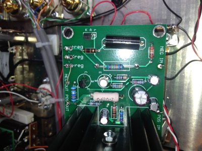

Reply #7 on: May 19, 2019, 06:43:40 AM
Last two.

You have a mis-wire on the filament board, red & black wires transposed.
Should be: red wire to +reg, white wire to Kreg and black wire to -reg.

Why, so I do. I had a suspicion it would be something obvious and right in front of my face. Thank you for pointing it out. Switched the wires and it now checks out. Thanks!
