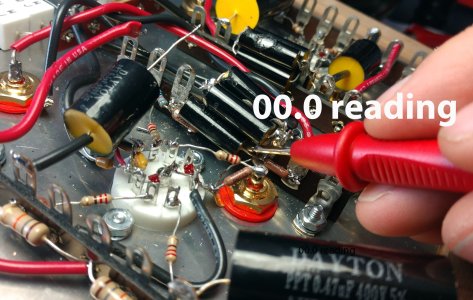

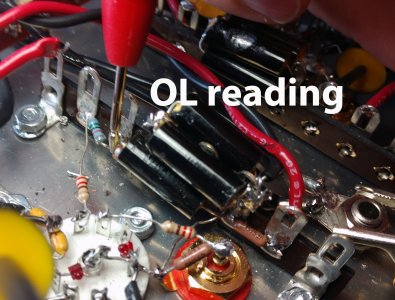

Hello all,
This is my very first build.  When I went to check the resistances I came across this issue... 13, 14 and 15 all read OL when I test them.  I tried resoldering the connections to no avail.  then I noticed the following.  when I check the resistance on the lead of the capacitor connected to 11L I get a reading of 00.00.  When I check the other lead of this capacitor I get a reading of OL.  Does that mean that this is a bad capacitor and the rout of my issue?  If not what advice would you give me to resolve this issue?

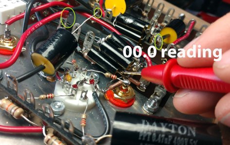

Hi Ben - I am just a novice diy-er, but I doubt the cap is the source of the problem. The fact that you read 0L on one side of the film capacitor and 0 ohms on the other suggests to me that the cap is doing exactly what it is meant to: blocking direct current (DC).
Unexpected OL resistance readings are likely due to a missed connection or bad solder joint. From your pics, one wire appears completely detached from its terminal and a couple of connections appear to have no solder. I have circled them in green. I would suggest inspecting all the joints from start to finish to make sure they are well soldered.
PB will likely have more detailed advice, but this is a good place to start.

Sorry for the confusion Derek.  I should have been more clear about the pictures.  I removed the two joints that you circled in order to get batter access to the joints where I was getting the bad readings.  They had the OL reading with and without these wires in place.  I have since reattached these wires.  I guess I will remove everything from these terminals and start over.
