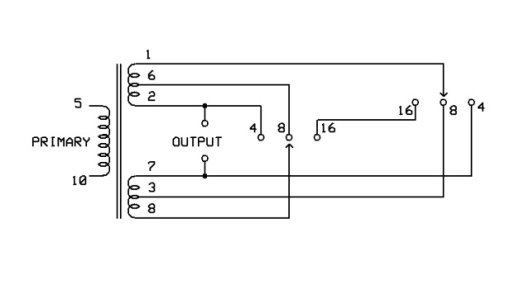

I believe that this will work for the OT-5, but I would wait until PJ gets home and confirms 100% for sure before implementing it.
Edit: looking at the Kaiju manual, the output transformer terminal number does not appear to be consistent between the Paramount and Kaiju, though this drawing could probably be renumbered to remedy that.
« Last Edit: May 26, 2019, 07:37:37 AM by Paul Birkeland »

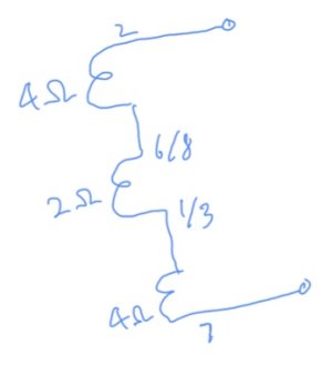

This circuit is great because that means I would only need one 2pdt switch per OT since I only want the 4 and 8 ohm configurations. In trying to understand this, I traced the 8 ohm configuration and got this simplified circuit. Is this correct, because that would give a 10 ohm impedance?

There isn't a separated 2 ohm winding on the OT5, it's a tap on one of the 4 ohm windings.  Two 4 ohm windings in series gives 16 ohms.  If you take a 4 ohm winding and put it in series with a portion of the other 4 ohm winding, you get to 8 ohms.
I started drawing out impedance switching for all four taps, but ran out of brain power and decided to eat lunch instead.

Reply #6 on: May 26, 2019, 10:00:53 AM
Hi, Paul.
I got the 2 ohm winding in my simplified diagram from two parallel windings: the 1-6 in parallel with the 3-8 (when the switches are in the 8 ohm position), unless I'm just not reading the diagram incorrectly.
« Last Edit: May 26, 2019, 10:02:41 AM by Raymond P. »
Raymond P.
    • Posts: 20286
Reply #7 on: May 26, 2019, 10:08:47 AM
Once you've put the two 4 ohm windings in series, there is no more copper to put in series with those.
Offline Raymond P.
    • Posts: 136
Reply #8 on: May 26, 2019, 10:16:18 AM
Hi Paul.
I'd like to confirm an assumption I'm making. Are the 1-6, 6-2, 7-3, and 3-8 windings in your diagram each 4 ohms? Thx.
Raymond P.
    • Posts: 20286
Reply #9 on: May 26, 2019, 10:20:35 AM
Hi Paul.
No.

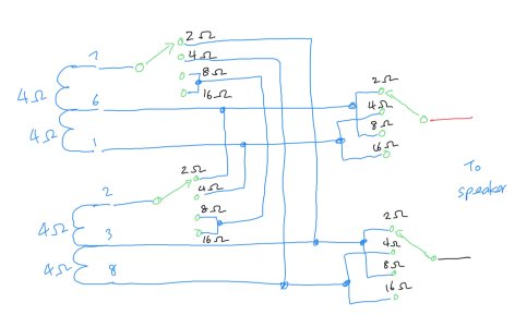

I was originally planning on switching between 4 and 8 ohm outputs using a toggle switch per OT, but the recommendation of using rotary switches makes it feasible to have more than 2 throws, so I've decided to have the ability to switch between all 4 output impedances. I came up with a circuit and attached the schematic for it in case anyone else is interested. I have not implemented it yet, and it may contain errors, so if anyone sees any issues, please let me know.
The switches in green are contained within one 4p4t rotary switch. The schematic shows one way to implement the switching. I believe there are other ways. I'd love to hear of better ways that would reduce the number of poles or pieces of wires to solder. TIA!
Edit: Here's a 4p4t rotary switch - https://smile.amazon.com/dp/B07JLQ38GP/ref=cm_sw_em_r_mt_dp_U_-aA7Cb9QR7NNS
