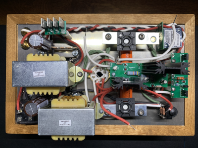

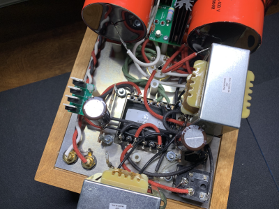

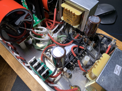

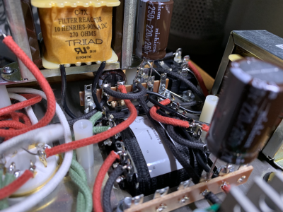

I went against my better judgement and installed everything at once. I know how much trouble this can cause and I'm not sure why I even did it... Things get a little crowded with this much stuff...I've tried to show how everything is wired. The 270 Ohm resistors didn't fare well on their removal, so I am an order away from returning it to stock. I've reflowed any questionable joints. Mind the soldering job...frustrations has taken over.
