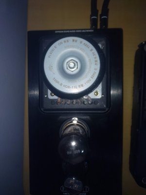

@Doc B. Yeah you got a point there, it'd actually be better to just ring up the Darkvoice company, or maybe even the transformer company to get their take, especially since they know the amp/transformer better than anyone, besides, they'd be able to give me the same mounting system as the original transformer too, making installation much less of a jury rig and much safer too. Funny thing is, when I took the picture of the transformer, I noticed the company engraved their website on the transformer for the first time yesterday, even after looking at the transformer quite a lot every time I disassembled the amp, so hopefully they have an English speaking representative/technician I can contact to see if they could consult me on the transformer swap.

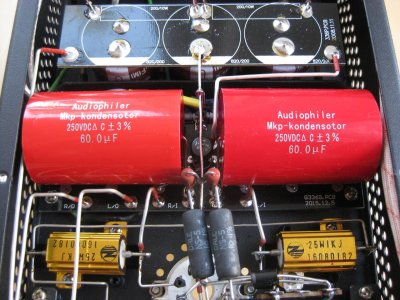

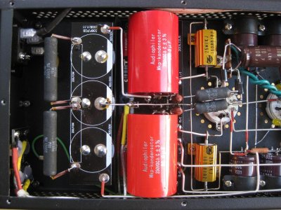

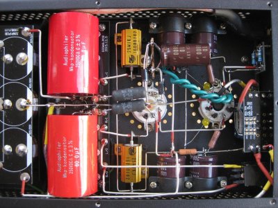

Also @Paul Birkeland Yeah the winding current worried me too, that's why I was weighing more on a complete transformer swap, but at least from the pics I've managed to find on a supposed successful attempt at a bridge rectifier for the Darkvoice (Pics Attached), it seems they used resistors to probably reduce the current draw for that same reason, since the amp is literally Input -> Switch -> Transformer -> ~7 V straight to the tube heaters (Pins 7 & 8 on both tubes), so I'd imagine the increased current draw would probably be bad for the transformer if there was no resistance there, although the resistance that I can see is .1 ohm and possibly 2-5 watt on the actual heater In/Out since it seems to be wire wound, and the other resistors I can't even tell their resistance since I can't see their ring colors/name and they guy who did the mod doesn't have the amp anymore to ask the values he used. Overall the bridge rectifier mod worries me since I can't tell what was done exactly to get an idea of how much current I need to drop since the pictures don't have the best angles on the resistors. Other than that he removed the grid resistors and biased the cathodes using LEDs, so I know those aren't part of the actual heater mod.

That modification looks like it drops the AC voltage going to one tube (which is still AC heated), then rectifies it to feed the other tube.  My experience with seeing this exactl kind of modification is that someone is chasing noise and trying various solutions.  The dropping resistors alone should be enough for you to achieve what you're looking for.
