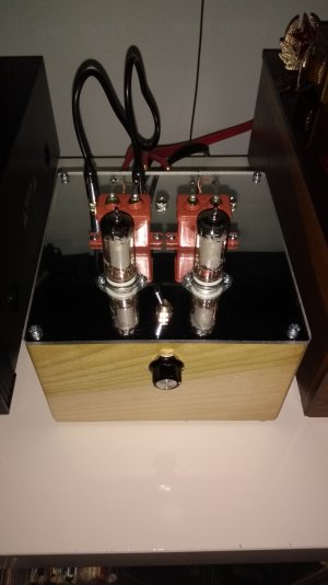

Hey guys! I searched first, but couldn't find any applicable topics, so I'll start a new one. Briefly, I've begun a very custom Quickie 1.1, point-to-point build (as the kit is no longer available). That said, I've designed and built working power supplies off the mains: one 45v B+ choke fed, and two 2.8v lm317 regulated + 10,000uf filtered filament supplies (discrete). OK, here's where I am...I was simply going to attach the 2.8v heater supply to pins 1 and 7 and then pin five goes the auto-biasing cathode resistor. Makes sense, but, the datasheet says if you run series filament heaters, then you must install a 'shunt' resister between pins 1 and 5 to prevent current 'back flowing' or something? Then, on https://www.radiomuseum.org/tubes/tube_3s4.html it clearly shows simply hooking up the 2.8v supply as I have. Does anyone have an opinion, or, has anyone tried this and succeeded/failed? Thanks in advance!

UPDATE: Just finished the build with 2.8v heater circuits strapped directly to pins 1 and 7. No problems. In fact, the pre sounds amazing. Such a simple but wonderful circuit and SLEEPER bottle. LOVE BOTTLEHEAD!!!! If you haven't experimented with an AC power supplied Quickie, you should!
