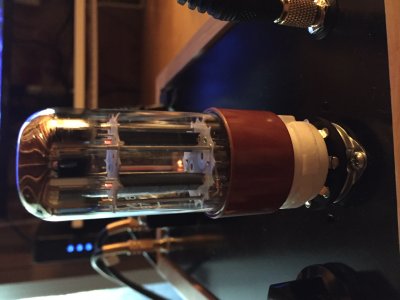

Hey everyone, sorry if this is a stupid question but I can't seem to find an answer to this...
I'm wondering if the Garage1217 12AU7 to 6SN7 is a plug and play like socket savers are? I hear 6SN7's are typically better than 12AU7's so curious to try it. Also, are there any risks of using the adapter because 6SN7's draw more power than 12AU7's don't they? Thanks for the help everyone!

I'm using one and it is definitely plug and play.

I have one of those too, and no noise whatsoever, I have a couple different 6SN7 tubes I used and no problems at all.  In terms of sound difference, I found that the power tube makes a just as much of a difference as the input tube.  I have a Tung-Sol Tall Bottle 6SN7 and a Sylvania "Bad Boy" Military Spec and they both sound great.  But I also have mine pared with a Western Electric 421 A which makes a HUGE difference in the quality of sound.
I also have a Telefunken 12AU7 and I would say they are all fairly similar with the WE 421A.

So I just listened with a Telefunken 12AU7 and then switched to a Tung Sol tall bottle 6SN7 and it seems like there more power and punch in the bass.  That's the biggest difference I noticed.  So are they "better"?  That's a matter of opinion.

I rolled in a 6SN7 and I really liked what I heard. Definitely more bass punch, wider sound, smooth treble. Cymbals still sounded crisp. Then I rolled back in my Gold Lion 12AU7 and I was like "WOW". Funny thing about all this , and what I've now accepted is that there is no best to my ears. I like what I like in the moment, and change it up once in a while for flavour.

After reading this post, I decided to try the Garage 1217 adapter, been listening on and off this weekend, works perfectly in my non-speedball Crack, no noises at all - it's completely quiet like the 12AU7.  They shipped fast and the price was reasonable in my opinion for such a well-made adapter.  Great service from Garage 1217!
Totally plug-and-play.  I love being able to try out the 6SN7s.
