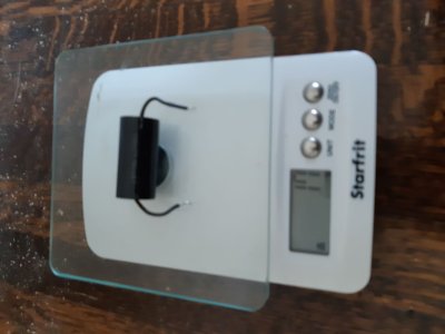

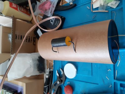

New caps for the upcoming Kaiju build.  Ridiculous!
That's a 10uF Dayton on top of a 10uF Miflex.
Edit: Just noticed that the Dayton is 250 VDC rated, whereas the Miflex is 600VDC. I imagine that a 600 VDC rated Dayton might be twice as big as the 250. So the size discrepancy isn't quite as large as in the photo.

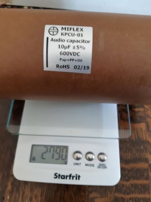

Weight comparison in grams.
For the non-metrically inclined: that's 6+ lbs each.  ... This is going to be a crazy build.
