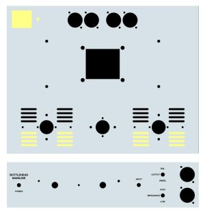

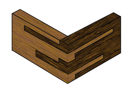

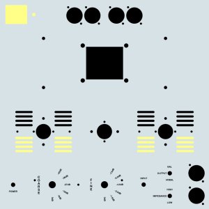

Now for some background about the project I've got planned: I've been toying around with the idea of making some physical changes to the kit to save space as space is a premium where I'm currently at. What I'd essentially like to do is build the base out a little differently by splitting the top panel up so that the controls and the headphone jacks are mounted on the front wood panel, with everything else mounted on top pretty much the standard way (though I might move the IEC connector to the rear wood panel). I'm also planning on making a custom panel (or set of panels if I split the one up) that will do away with the plastic control faceplate. Additionally, the wooden frame I've planned will be increased in height an inch or so and it will be built out of walnut or a combination of walnut and maple.
I've adding a few pix below to help illustrate the project.
Now the question: does anyone see any reason why I couldn't (or shouldn't ) split the top panel up as I've described? There'd be plenty of room to do wire routing internally that could accommodate the changes I've proposed. I'm also fairly well equipped electronics wise (I bench high end computer components).
TIA for any advice; it'd be much appreciated.

Sure, this could be done and made to work, but it will change all of the wire lengths and make some of the routing a bit more difficult.
I would keep the plastic overlay though, as there's a lot going on with those controls and it can be difficult to remember what is what!

Any new panel I make would include the labeling that exists on the plastic overlay; and if I need to mitigate any differences in component installation heights, I'll use shims/spacers.
As for the length of wires changing and routing, understood. I've got the test equipment I need to keep an eye on changing characteristics and plan to compensate for them if/where needed. It's been a while, but I've worked some pretty complex wire-wrap back planes in the past.

You'll have to be really careful that the attenuator doesn't run into the components on the top panel.  That stuff hangs down pretty low under the top panel, and I'd leave a decent amount of clearance so you can get in there and build everything properly.

Thanks! Already thought of that and I plan on adding a bit of height to the wooden frame to allow for that. Probably make it five to five and a half  inches tall (instead of the four the stock kit provides).
