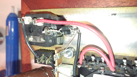

For those who can hear their computer working away through their Crack or who are using a powerline ethernet kit and hear lots of clicking and static, a ground breaker installed in place of the buss wire between the chassis and the ground tab of the IEC power entry module will very likely solve this issue.  I recommend using a diode that's rated for at least 2A, and the voltage isn't particularly important.  Part number STTH2R06 looks to be a solid choice.  I do not recommend using a Schottky diode here.
I've attached a photo of how this is retrofitted into a Crack.

This is very cool.
@PB: can you explain how it works?
It doesn't make sense to me. Two ideal diodes paralleled with reversed polarities would do nothing, right?  All current/voltage would pass unimpeded in either direction. So I figure it must work ONLY BECAUSE real world diodes are non-ideal.
I've seen ground loop breakers that employ a diode bridge with a resistor and cap to greatly reduce ground loops - but you're using only the diode bridge. Does the tiny amount of resistance and capacitance of the diodes do the trick?  Or is something else at work here?
It separates the safety ground by the voltage drop of one diode (in either direction).
Yes, a perfect diode wouldn't allow this arrangement to work.

Reply #5 on: June 22, 2019, 06:58:33 AM
A little more specifically, if you have a small AC voltage, say 100mV, the diodes present a pretty large impedance and this is what's broken.  If you have more than about 0.7V of anything AC or DC, then the diodes will start to short that out.
@PB: why not a Schottky?
Many thanks, Derek
You want the forward voltage drop to be significantly higher than the magnitude of the noise you're dealing with.  The low forward voltage drop of a Schottky diode in this instance is a bit of a disadvantage.

I’m thinking about giving this a shot. Is there any amp in the lineup where this would be unsafe or a bad idea? I assume not but don’t want to make a costly mistake.

I don't see issues doing this with any of our products.  I do also plan to test whether a UF4007 can throw a 20A breaker and survive, as this could also be a suitable part to use.

Reply #13 on: August 11, 2019, 10:47:24 AM
In the event of a catastrophic failure, you may need to check and replace the diodes.
