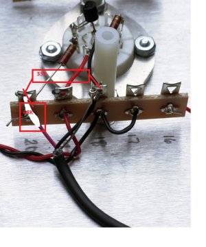

The BeePre is not quite as quiet as the old Foreplay, but there is certainly a way to improve upon things a bit.  Since you have the BeeQuiet, what would you say is the maximum amount you have the BeePre cranked up?  If there's some room in the attenuator, then you can add a resistor to each Paramount to pad down the input a little bit, which will reduce the apparent noise from the BeePre and also reduce the microphonics a bit at the same time.

Thank you for the great idea. I still have plenty of headroom so it should be no problem padding down the Paramounts a bit. Also thanks for confirming my suspicion the BeePre has a tad bit more noise compared to the Foreplay - I'm relieved I won't need to poke around inside the BeePre trying to track down the source of noise!

If you let me know how high up on the controls is the highest listening level, I can help you determine the correct resistor value to add to the Paramounts.

Can you please re-post your last response with the recommended resistor values and installation photo? I saw it last week, but then it seems to have disappeared since then! I want to make sure I install the new input resistors correctly in my Paramounts. (I'm trying to reduce input sensitivity by 9db.)

I'm on vacation and that image is on a machine at home, but here's the idea.  I lowered the resistance values a little bit as well IIRC.

Perfect - Thank you!!!
