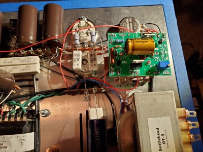

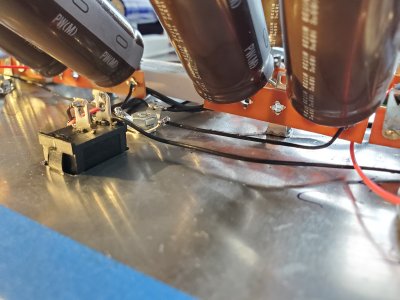

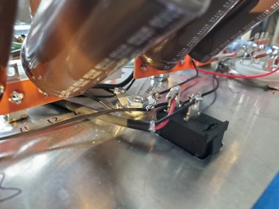

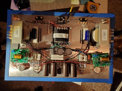

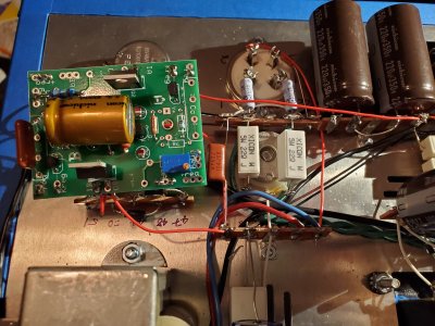

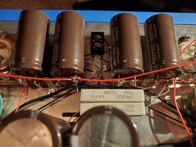

I attached some pictures below with what I have done so far. Any help would be greatly appreciated.

Hi Kevin - I am just a hobbyist with a shaky at best understanding of a tiny fraction of this stuff, so this is just a poorly-educated shot in the dark. 524V at IA/IB seems pretty high given that the target is approx. 450V.  This suggests to me that the problem lies with the power supply circuit with the six electrolytic caps and the two 120 ohm 10W dropping resistors. I would double check that everything is wired to the correct terminals. If that checks out, I would then focus on the the 120 ohm resistors. Maybe desolder them completely and resolder them after crimping the leads to the solder terminals.
Going by your pics, I might also touch up the power supply cap soldering by bending and crimping the cap leads around the terminals and adding a touch more solder.

I'd also check that none of the leads of the 120R 10W resistors isn't making contact with the chassis -- and in particular, that a lead of the 120R closest to the front of the amp isn't in contact with a screw or nut securing the solder terminal strip.

I went through all your suggestions and found nothing wrong. I decided to go back and look for issues with the board. I didn't think it was the boards, because the issue was symmetrical. So I figured that the issue might be somewhere in the middle of the amp. However, because I built the C4s boards along sides one another, when I missed the step where I connect breg on B and bB, I missed it for both boards.
I added the wire, and now everything is working.
