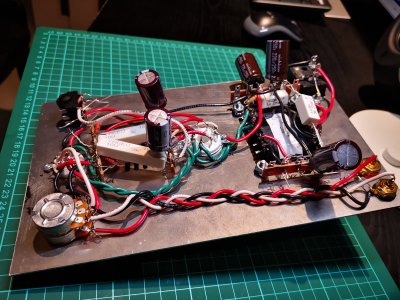

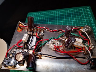

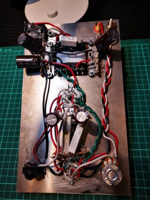

Thanks Jameson.  Here are a couple of photos of my build.
Ben Chiou

Reply #4 on: August 08, 2019, 10:15:52 AM
You definitely want to trim those excess leads much closer to the terminals.

Reply #5 on: August 08, 2019, 10:20:55 AM
The LED is unlikely to be the issue.
All those leads sticking out must be trimmed, then take another set of measurements.
The high voltage at terminal 5 and the LED not illuminating suggest that perhaps the solder joint at A4/A5 is not well formed.  If this is the case, only one half of the 12AU7 will glow.

Thanks Jameson and Paul,
I trimmed the excesses and resoldered A4 and A5.  The voltages are all accurate and both LED works now.  Can't wait to start listening!
