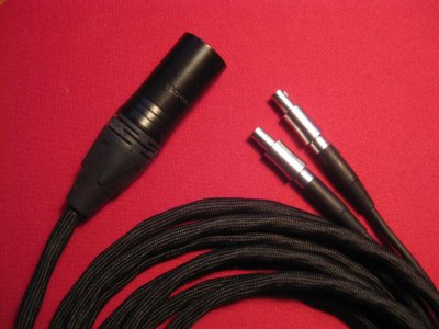

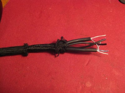

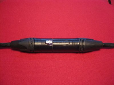

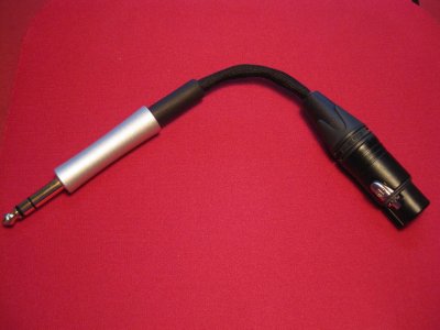

My HD800 cable was not litz (thankfully), so it was easy to solder.  Its actually two separate cables in there when you peel back the outer wrap, each two cores with a shield.  The smaller two in the bundle are just stringy rubber to give it body and stress relief.
Neutrik male and female four pins are what you need.  Cut the original connector off with 6" of cable, then attach the female XLR socket to it.  Voila, you now have a converter cable you can plug back on to use the headphone in a conventional TRS amplifier ;)
