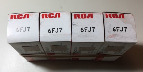

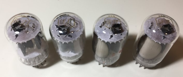

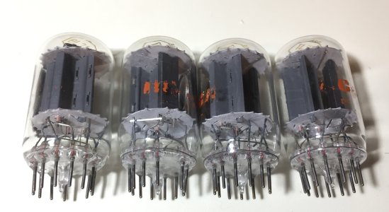

Ok - here are some PICS -

EIA Base 12EJ has pins 3 & 8 both connected to the grid of triode section 2. My guess would be they are 6FM7.
