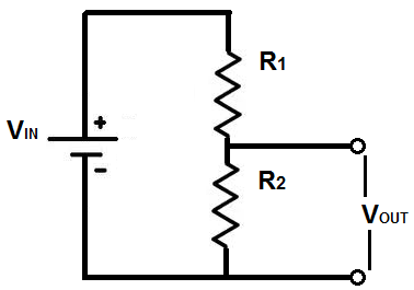

I have an RCA connector barrel that will let me put my own resistors in there, so I figure I can make a single L-pad shunt attenuator with my needed ~40dB of attenuation.  There are many combos of series and shunt resistors that will accomplish this, so I guess the question is: what is the ideal impedance for my attenuator?  10K? 35K? 50K?  More?

To make a -20dB Harrison Labs style attenuator, you would want a 9.09K series element and a 1K shunt element.  If you get reasonably small resistors, it's possible to just build these into each plug on your interconnects that plug into the amp.  Some solid state amps will have RCA jacks that are wired with short wires to a PC board, and that's another place where it's pretty easy to add some padding resistors.

Next, I populated my RCA barrels with a 16.9K Vishay Dale CMF .1% 1/4W series resistor and a 698 ohm Vishay Dale CMF .1% 1/4W shunt resistor.  This achieves ~28 dB of attenuation, while still approximating the source impedance of 700 ohms (@ 698) and the load impedance of 18K (@ 17.6K) that would be there with the preamp directly connected to the power amp.
