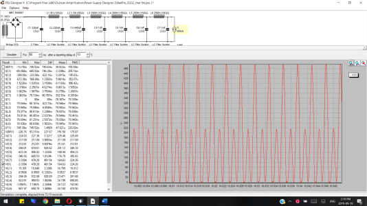

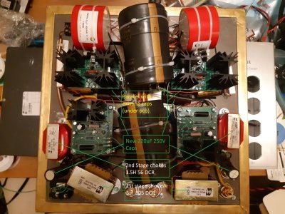

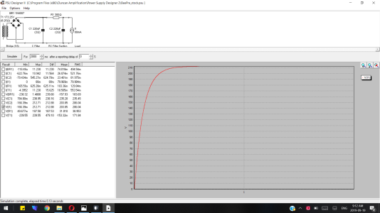

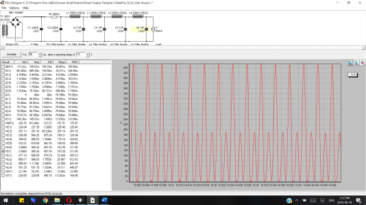

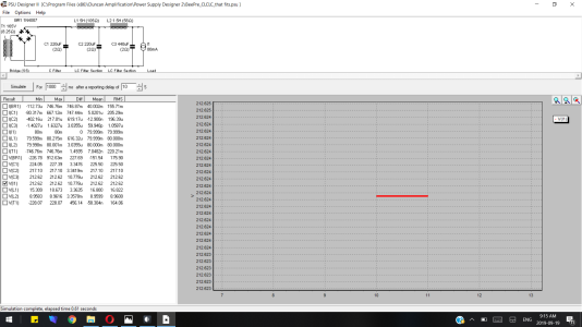

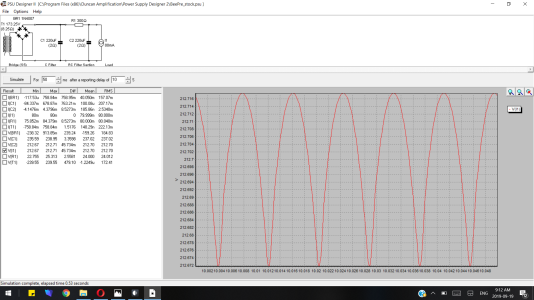

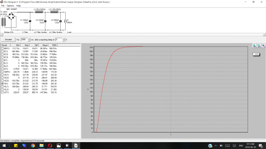

Last night I modified the stock CRC filter in my Beepre to a CLCLC filter: 220uF -> 5H 105 DCR -> 220uF -> 1.5H 56 DCR -> 440uF.  I made this change "just to see". Annotated photo and PSUD sims of stock and modified power supply attached.  In simulation at least, the new combination matches the stock output voltage closely, reduces ripple to almost nothing, and adds a total of 440 uF of extra capacitance (which wasn't a goal - it just worked best this way in sims).

The above listening impressions are inconsistent with those of at least Aaron J (I will post a link to his impressions in a later edit), who IIRC replaced the stock CRC filter with a CLC filter (I think a 10H). I'm not sure what to make of this. My PSUD sims suggest that two LC filter stages, even with lower total inductance than one might have with a single stage, reduces ripple to a greater extent than a single stage.  And perhaps the added capacitance plays a role.  Or it's just my imagination - but I don't think so: the experience of listening to a piece of music with which I am very familiar and having it sound not just "better" but like a completely different performance suggests to me that the change is real. I had a similar experience with my first Stereomour II after adding the Shunt Reg upgrade.  The sonic effects of the CLCLC change isn't of the same magnitude as the SR Stereomour upgrade, but it's in the same ballpark (to my ears). Now, this may seem crazy, since both the BeePre and Kaiju are already regulated out the wazoo. How can adding some PSRR further up the power supply chain make any difference when ripple is already reduced further down the chain to negligible levels? I dunno. Maybe it's just the added capacitance. Or maybe it still makes a difference. Regarding the latter possibility, I am reminded of some of PJ's comments on the AA forum (See my "Couple of Quotes ..." post in General Discussion some months ago) to the effect that he had been experimenting with stacking CCS and shunt reg isolation from the power supply and could hear a difference even when accepted engineering standards suggested that the changes would be inaudible.

Some installation notes. The 1.5H chokes are only 1.5 inches wide, and so fit fairly easily alongside the pcb-covered power transformers. The 5H chokes, however, are 2 inches wide and 3.25 inches long. One fits diagonally near the IEC inlet, but to fit the other I had to remove one pair of the output jacks and one pair of the input jacks - so now I have 4 big holes at the rear of the chassis that I will probably cover with some mesh screen.  So the aesthetics took a bit of hit - but I'm ok with that. Other may not be. But I think this could be avoided by mounting the chokes on a t-shaped bracket so that the chokes stand parallel to the chassis rather than perpendicular to it. Or maybe you could mount them on top of the chassis.
I should note, too, that in installing the chokes in both BeePre and Kaiju, I added a "flux band" to each choke. The band wraps around the outside of the choke in parallel with the direction of winding (so around both the winding, the EI core and the frame). The bands are three-layers: 30 gauge copper sheet, some EMI shielding foil called MCF5, and a very thin layer of copper foil tape around the two previous layers to hold them together. The band is wired to chassis ground.  The MCF5 EMI foil is made by a German company that claims a -30dB attenuation of low frequency interference (IIRC this encompasses all frequencies in the audible bandwidth) and much greater attenuation of high frequency interference. I obviously cannot confirm this. I can post a link to the datasheet if anyone is interested (although it is easy to find with a google search).
Lastly: a product recommendation. In the photo you can see some clear thick tape wrapped around the big 22k uF Nichicon caps. It is silicone gel tape that you can find on Ama*zon and other online retailers.  It has some very useful properties for affixing and separating parts in an amp: it is sticky and strong as hell, but can be peeled off (with effort - this stuff really grabs) without leaving any residue; it is electrically insulating; and presumably b/c of it's gel-like consistency adds some vibration damping.  It is a bit difficult to cut, though. I recommend a strong and sharp pair of utility or kitchen shears.

If you want to look at what the regulator is doing, put a node in PSUD that's a 1000H/600 ohm choke and about a 10uf cap.  Since PSUD won't let you do 1000H, you could approximate it as CLCLCLCLC where each L is 250H/150R and all the middle caps are 0.001uF.
Deke609
Reply #4 on: September 19, 2019, 08:22:35 AM
@PB - I can't get the PSUD sims of the regulator to work. What I tried: adding 4 x LC stages of 250H/150R and 0.001uF cap, with and without the last cap as a 10 uF. I tried tacking this on to both the stock filter and my CLCLC filter. With the 10uF as a the last cap, I get some sort of timeout error and the sim stops. Without the 10 uF cap at the end, I get totally screwy results. See attached screenshots.
Is my setup wrong? When you say "add a node", is that some sort of special configuration in PSUD? THe only other option I see besudes adding a regular filter stage or load is a "current tap". Is that what I use?
many thanks, Derek

I did run a PSUD sim of the stock filter with 440 uF instead of 220 uF and it works fine and looks pretty close to the original. So when I get up the gumption to remove-then-reinstall those big nichicon cathode resistor bypass caps, I'll try reverting to the (mostly) stock CRC filter (but with 440 uF at the end).
