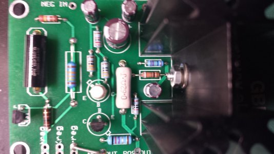

Hello All,
I got my BeePre kit yesterday and will receive my Crack and Speedball next week ,Yeah!
I'm a little paranoid regarding the body size of the 931 Ohm resistor on the filament regulator board.
It looks more like a 1/4w than a 1/2 w. I'm sure I am wrong, as I often am.
Please see the pic and tell me everything is going to be alright. Ok.
Lee

Reply #1 on: September 19, 2019, 06:12:45 PM
You're good for that Rset2 resistor. It doesn't look like the one in the BeePre manual, but it is 1/2W
Reply #2 on: September 19, 2019, 06:30:02 PM
That resistor dissipates less than 0.1 watts.
