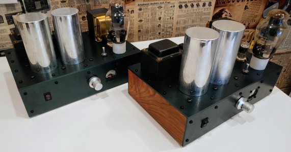

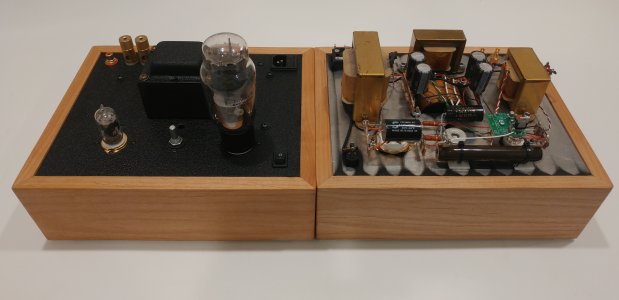

PJ's suggestions are all items that I've built into some of our vintage amps.  I tend to replace every single capacitor in a Bottlehead amp that old and replace the cathode bias resistor for the output stage with something much, much larger.  For a directly coupled 2A3 circuit, the 2nd revision of the Paramount 2A3 driver stage design that PJ came up with is still ridiculously good and something we have not been able to improve upon in the last ~10 or so years, and I would recommend adding that during the reconstruction.  It will allow you to dial in the current of the 2A3 very tightly, which will provide the perfect balance of power output from the amp and happy output iron.
I have also rebuilt these vintage amps onto 8x10 chassis plates, as well as other larger chassis designs with significantly more space to allow for better cooling and a less constricted layout.
