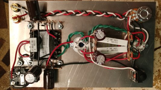

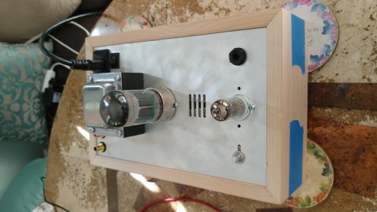

Reply #10 on: October 26, 2019, 04:12:44 PM
Took awhile to get back to posting pics. Listened to it anytime I got near it  ;D
    • Posts: 20290
Reply #11 on: October 27, 2019, 05:11:15 AM
Can I see some closeups of the wiring on the headphone jack?
