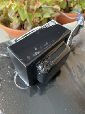

I waited the 48 hours suggested by Rustoleum to clear coat my chokes, but it's been a little cooler out than typical and it seems like the last layer of paint hadn't set yet. Tragedy struck on one of the chokes and the paint buckled. Looks like I'll be starting over.
Do yourselves a favor and let your paint cure longer than you think is necessary.

Were you clear-coating over paint you'd applied previously? If so, it's a common problem with recoating using enamel spray paints; I've encountered it before, though not to the degree it appears in your photo.
In spite of label instructions, I've found that recoating seems to work best within a short time (about 15 minutes or less, which is often per the label), or not until at least a couple of weeks later (which is also often per the label in many cases). If memory serves, I have tried topcoating with clear (same brand, same type of paint, per label instructions) within the recoat time, and experienced a 'wrinkle finish' effect, though not quite as pronounced as yours appears. Similar, though - as if the topcoat has somehow expanded and wrinkled to give the excess someplace to go. This has even happened to me long after parts have been dry.
Temperature is a factor, of course, but I've found recoating to be tricky business. I've pretty much settled on only recoating during that 15 minute window when using enamel, and not at all after that.

To answer your question, caffeinator, I followed the same process I had on the transformer bells previously: hit them with a couple coats of flat black enamel within a few minutes of each other, let dry for a couple days, come back and hit them with a couple coats of clear within a few minutes of each other. It worked fine last time. This time... well, you can see for yourself.

Try acetone and a rag to remove the paint. Since it hasn't cured for that long it will probably come off pretty easy. Work in a very well ventilated area (like outside) and wear latex rubber gloves (the acetone will destroy synthetic gloves like nitrile or PVC). Since the finish isn't messed up all over it makes me wonder if there was some contamination under the bad spots. Acetone is also a really good solvent for paint prep, removing oils that might be in the pores of the metal.
