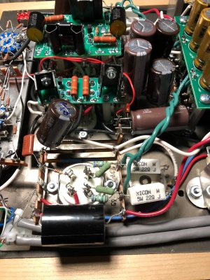

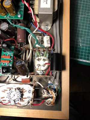

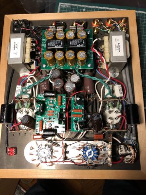

Here are some pictures.
Thank you very much for your help
David
Reply #10 on: November 09, 2019, 10:08:12 AM
What is the value of the writing on the green resistors?
Yes, that cap has blown because it was exposed to too much voltage.  The resistors blew for the same reason.  When you get a new cap installed and new resistors installed, you will likely have some voltages that still aren't correct, and this would be consistent with a 2A3 that's damaged.

Reply #11 on: November 09, 2019, 10:19:35 AM
It is written R13 5% 3W
