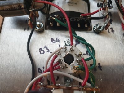

Hi,
I just built a Crack as my first electronics project.
It was all going pretty well, passed as resistance and voltage checks, i plugged it in and all was well. That was yesterday.
Today i noticed a slight hum in the right channel that went away temporally if i tapped the top metal plate, but the hum would return after a few mins.
After reading through the forums I decided to re-flow some of the joints, mainly around the volume pot. they all look good now (to me anyway) and i checked the resistances again and all good.
Then I tried to check voltages. I got fluctuating low values on 1 and 2, and when i checked 3 there was a spark and now I can see some black marks on the right side 10W 3K resistor and am reading 0V on terminals 1-10
Any advice would be great.
Euan

    • Posts: 20297
Reply #1 on: November 17, 2019, 05:59:00 AM
You may have just blown a fuse, have you checked that?
I would reflow all of your joints, not just the ones on the volume pot.  I can see a few that look like they could use some more heat.

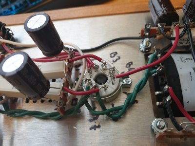

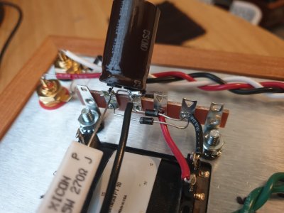

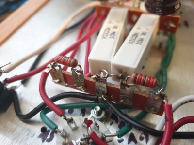

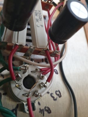

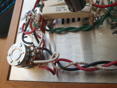

Are there any joints in the pictures that look okay and what I should be aiming for or any that particularly need reflowing?
Many thanks,
Euan
Beyerdynamic DT 1990 Pros | Crack + Speedball + Alps Blue Velvet + Panasonic PP Output Caps
    • Posts: 20297
Reply #6 on: November 17, 2019, 10:50:28 AM
I would just reheat them all and add a tiny bit more solder.
