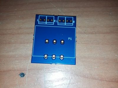

is this the board? could you clarify how exactly it should be wired up with the board? I was also considering the resistor mod to give me more usable range with the volume, can you advide how that would be wired up?

There are tons of boards for that pot, and all the ones I've ever seen up until now had labels on the solder pads.  You'll have to talk to the seller of that board to ask what goes where, or you could study the board on your own to determine that.  It has also been my experience that once you've soldered wires to the pins on an Alps pot, the pins may also break if you try to remove them, so I would just leave it alone until you have a replacement pot in hand.
