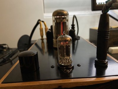

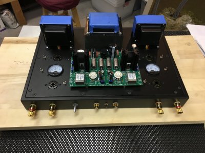

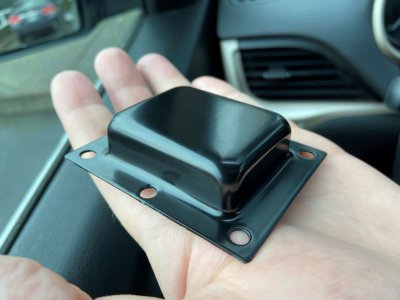

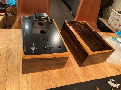

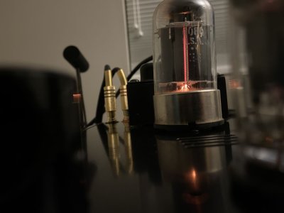

Hey Paul - following up on the powdercoat experience with NW Powder Solutions. I think they did an AWESOME job, were great to work with, and very professional. There was practically no overspray on the underside of the plate and none on the transformer top. No beading or other imperfections.  They were able to get my parts in over the weekend and it only took 5 days (including the weekend) for me to get the finished parts back. I couldn't be happier and would definitely recommend!
Attaching a couple pics of the finished build :)
