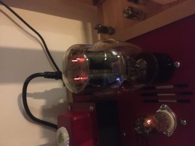

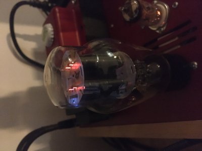

So. I bought my first few old 2A3's for SII (Finally!  :D).
These tubes all test +-50-60% on my EICO tester (--> FAIL!  :-\ ). Sovteks test 100+.
In the EICO, they do OK, no shorts, no signs of gas *(that last is a simple test of emissions with grid connected to ground vs floating). Now these exhibit blue glow around the internal elements, a very whitish-blue, when cranking the plate voltage a bit.*
They sounded good (Even while "cold" for the short time minute I had the amp on for these pictures)!
Are these safe to use? All have the same results on the tester. Only one pair tested in SII.
Can i try "burning in" these? Any suggested method?

Reply #1 on: December 10, 2019, 04:34:38 AM
That blue glow doesn't look problematic.  Those tubes probably have some life left in them where they will still sound decent.
