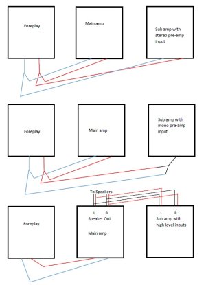

Carl,
I attached a simple diagram of hooking up a sub amp with either mono, stereo or high level (speaker) inputs. I like using the high level because once adjusted the pre-amp volume controls both.
Good luck,
Karl5150
Sr. Member
634
Re: How to add a powered subwoofer w/ Foreplay?
Reply #6 on:
December 27, 2019, 06:14:19 AM
That is to say with the speaker level inputs there is generally less need to adjust the sub amp volume once set.
