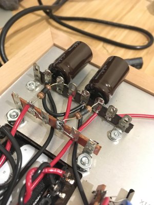

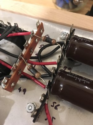

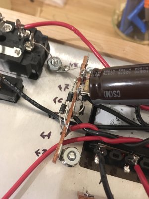

So, assumed all was ok and moved on. Powered on and tubes lit up (although the right one seemed brighter). Powered down and flipped the kit to see some smoke and those two 1KOhm-1W resistors between terminals 53-60 and 51-57 browned out.
Any ideas on how to diagnose and/or fix the problem?

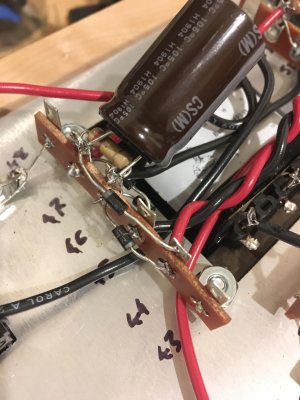

I had some problems with the diodes between terminals 44 through to 47 as I think I soldered something before I was supposed to and had reflow and get the new leads through which was a bit awkward.

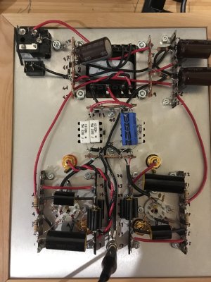

Could you post some photos of your build and a complete rundown on resistances?  You definitely don't want to turn it back on for now.

Reply #2 on: January 01, 2020, 03:37:46 PM
Hi Paul,

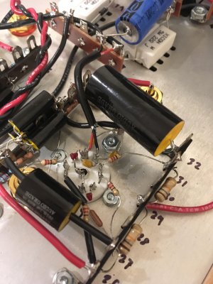

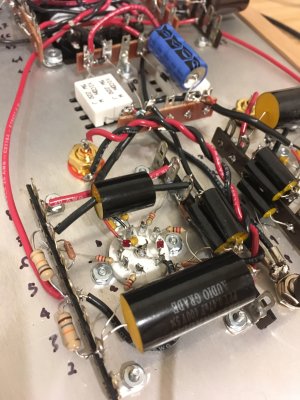

Reading and pictures as requested;

Reply #3 on: January 01, 2020, 05:49:35 PM
You have a miswire at terminal 4 which has connected the output of the power supply to ground.
