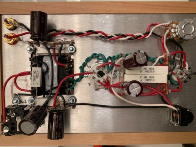

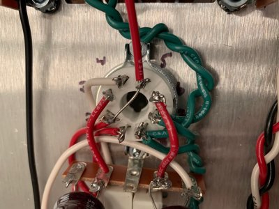

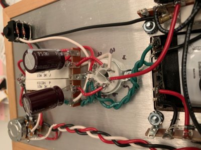

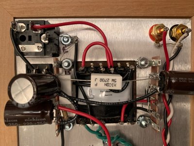

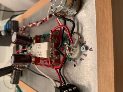

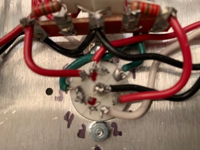

Offline Jsin
    • Posts: 21
Reply #12 on: January 01, 2020, 12:31:28 PM
Here you go. Hope you see something!
    • Posts: 20292
Reply #13 on: January 01, 2020, 05:45:56 PM
You need to get your solder joints much, much hotter.  Many of them have not flowed out.  If you have an adjustable solder station, crank it all the way up.  If you have a non adjustable iron, hold it onto the joints until the solder liquefies, then flows into the joints.
