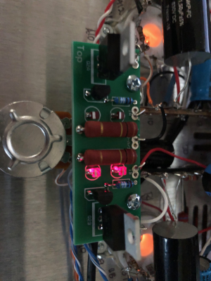

After having a full functional SeX 3.0 for many months I decided to build the C4S today.  Build and install were pretty easy, voltage even measured within the given range from the manual (OA @ 68.2V DC+ OB @ 70.4V DC) but only the OB (right) side of the board lights up.  The left (OA) side LEDs do not.  I have included pics of the board with power showing this and a few others.  Hopefully someone can see or recommend something.

You need more solder and more heat on most of those solder joints.  As an example, I can see through the hole on the board at the IB connection.  That needs to have solder covering it, and you need to heat that solder till it flows through to the other side of the PC board.

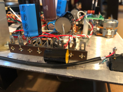

There is one wire to the lower connection of the right hand tag of the strip, should there be another to the top hole?
Yes, some extra solder needed and a at least one wire waiting to be trimmed I think.

Reflowing some solder to the joins PB mentioned did the trick.  Kudos to seeing that in such a grainy pic!
