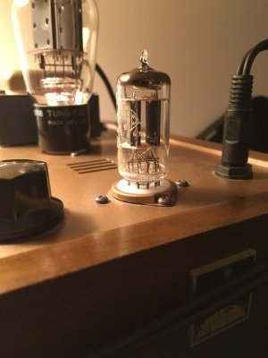

Hi everyone, I’m a newbie to the tube amp world. Sorry if this is posted to the wrong place.  I cannot for the life of me get my preamp tube to sit flush against the socket. I’m afraid of breaking the tube if I push it more than I already have. If the tube is up about a 1/4 inch can this affect audio quality or cause damage?  Any tricks for getting the tube in easier?  Thank you so much for any advice!
P.s. I have tried multiple preamp tubes in that socket
     Everything sounds fine and there is no distortion

I would think that there is something inside one or more of the pin sockets.
have you looked down inside the sockets with a light?
It's doubtful that solder has flowed in them as the solder tabs are pretty much sealed from the pin sockets.
I guess its possible that a pin socket is deformed also.
Bust out a magnifier and a light and take a gander.
Good luck.

I would do the visual inspection and then pick out a cheap 9 pin tube and use that to find out, just how hard you have to push to get it to seat properly. I would spare the Telefunken that is showing in your picture.
Small tubes are pretty robust. You can even rock the tube side to side to a degree, if pushing straight doesn't get you anywhere. Don't use a hammer.
Having the tube sit a bit high makes no difference at all to the audio quality as long as all pins make contact and they do in your case as "everything sounds fine".
« Last Edit: January 04, 2020, 07:02:50 AM by grufti »

My vote goes for push it harder. The first time I ever put a tube into a socket I was surprised by how much force it required. Also a new socket will be stiffer than one that's been used, so expect it to get easier with age and use.

If the tube is making contact and operating properly, I'd suggest just leaving things alone - provided you don't find any obvious obstruction.  Given that you posted a few days ago, has anything turned up as in the way?
