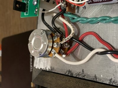

This is probably best resolved by posting some build photos.
Back in the Crack 1.0 days, it was super common for people to forget the connection that goes between the pair of pot lugs where the black wires connect, is yours present?
Is the volume stuck all the way up or all the way down?  If it is always all the way down, that could be too much solder on the center pin of the jack shorting it to the shell of the jack.

Stuck all the way up, it almost seems to get a little louder as the other channel fades. But might be my imagination. I do have the bridge in place, and all of the connections seem rock solid.

I would resolder all of the joints where black wires land.  Those readings tell us that the pot is working just fine, so that leaves the most likely problem to be that the pot isn't well connected.
At the 1.8 ohm resistance reading from center lug to the ground lug, the output of the pot will be muted unless the ground lug on the pot isn't well connected.

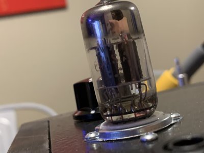

Hey Paul, only the back half is glowing currently.

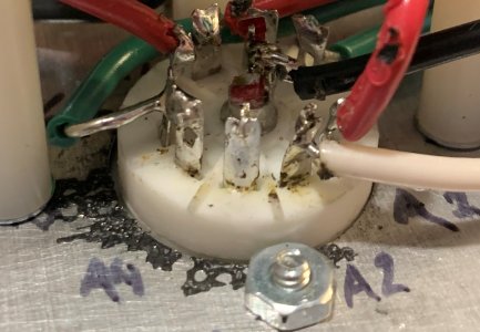

The solder joint at A4/A5 is not sound.  Reheat it/reflow it to restore glow to both sides of the tube, then that LED should come back on.

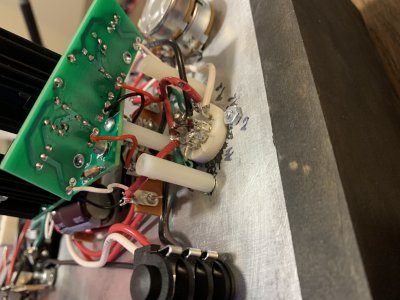

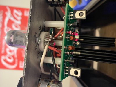

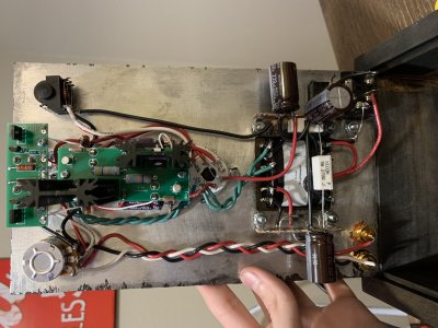

Under the small board is currently (visually) a mess from me trying to sort this out. But all the connections look solid to my eye and terrible photo.

If the tube doesn't glow on both sides (but does glow on one side), then the solder joint at A4/A5 needs attention.  Unscrew the PC board, slip some of the bare wire through A5, then loop a little more through A4.
That is what you absolutely must focus on 100%.  The LEDs will not light up unless that issue is resolved.
