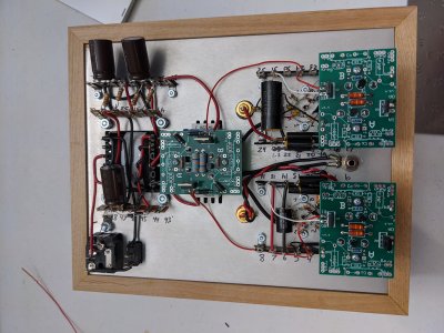

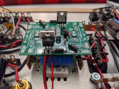

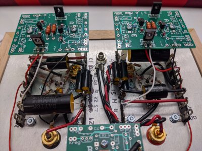

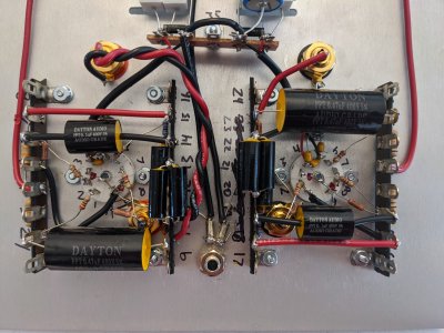

Can you post photos of the build?
Offline Matt Rendall
    • Posts: 7
Reply #2 on: January 10, 2020, 06:08:55 PM
Hey, thanks for the response. I'll attach a few. Please let me know if you want to see any specific parts closer.
