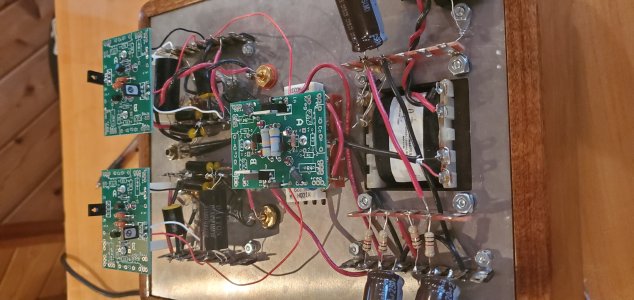

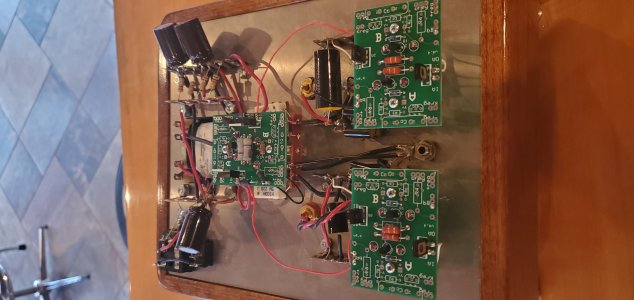

I'd post some photos of the build as it sits now.

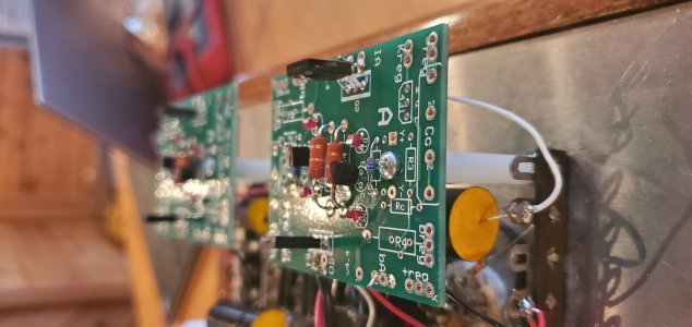

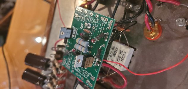

Let me know if you need photos of anything specific:

On the center upper board on the side reading 1.5V, slip the red teflon wire out of the board (it will be connected to OA or OB).
Remeasure the metal tab on that transistor and see if it stays at 1.5V or pops up to ~100V.
