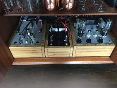

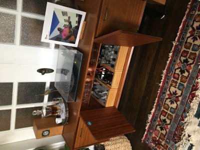

Reply #13 on: May 30, 2020, 06:14:31 PM
Well this is what happens... I've upgraded to the Stereomour and Eros and couldn't be happier. I'll do a more complete write up, but just thought I'd bing this thread full circle.

Reply #14 on: May 31, 2020, 05:44:16 AM
You lucked out with the width of the space in there!  You couldn't even fit a "wafer thin" mint in there ;)
