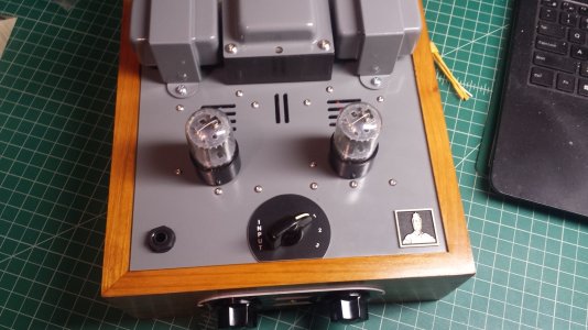

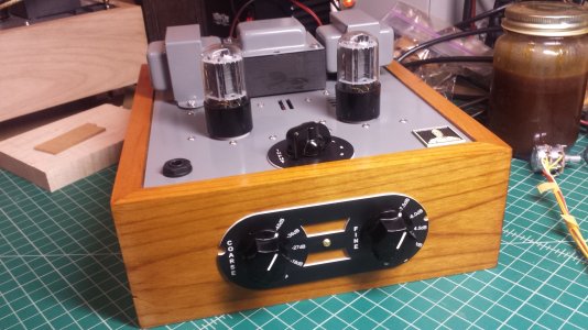

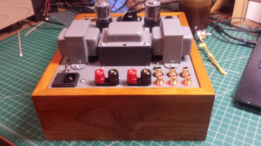

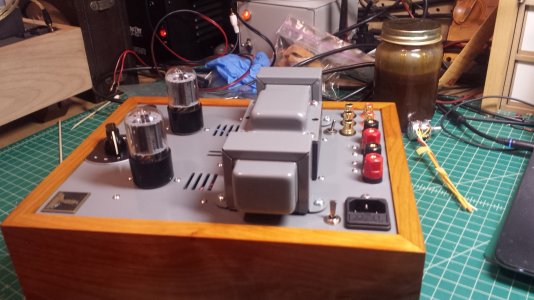

Hey Folks,

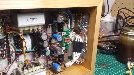

I just finished my S3X and could not be happier. Using speakers the amp was dead quiet before C4s and remains so afterward.
The 8 Ohm setting sounds better than the 4 Ohm setting on my Paradigm Atoms ( I believe they are 6 Ohm imp.)
Using HD650s is awesome, the 4 Ohm output has less gain but has a more linear response than the 8 Ohm setting which has more gain with some bloating in the upper bass and a treble boost, interesting.
I think I will install another 4pdt switch to switch between the C4s and the original plate load resistors.
Modified BeeQuiet works well. I trimmed the bezel and used the "Input" part on the top plate under the input selector.
A brass portrait of Doc B sits to its right.
The chassis plate is done in a utility grey color. I need to touchup the shellac on the front corner of the wood base that my housekeeper decided she should bash against something to give it some character. I've told her it is not necessary to clean in my evil laboratory but I guess she does anyway(I wish she wouldn't) Oh well if this the thing that really bothers me I guess I'm doing ok.
Ok then stay tuned to any of my future S3Xual EXploits.
Peace out.
