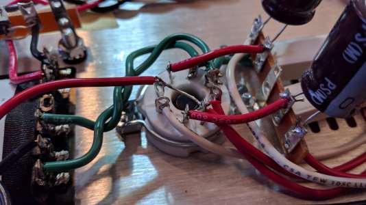

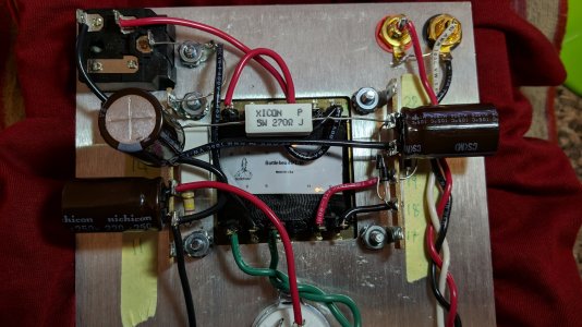

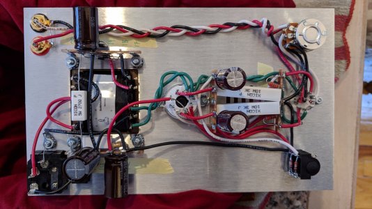

Also added photos below.

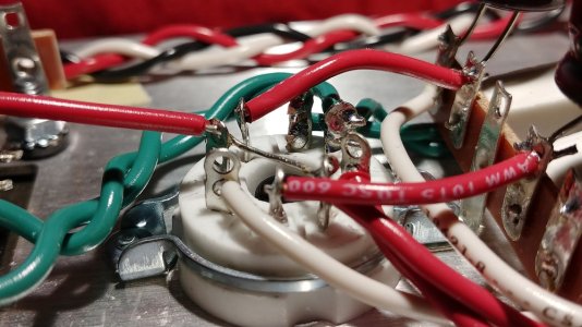

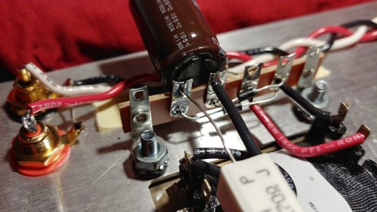

20U and 21U do not look to be all that well soldered.
Offline tsuid1
    • Posts: 15
Reply #6 on: January 23, 2020, 02:13:19 PM
The 12u7 tube glows but not the 6080. I'll try to add more solder.

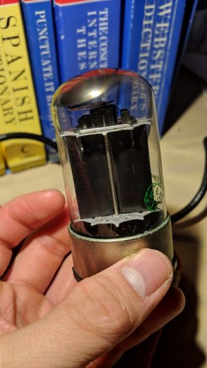

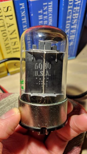

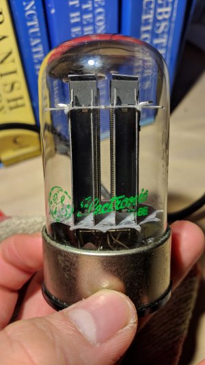

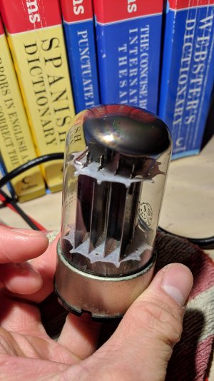

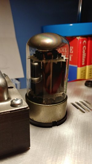

B7/B8 make the 6080 glow.  Can you post some photos of your 6080?

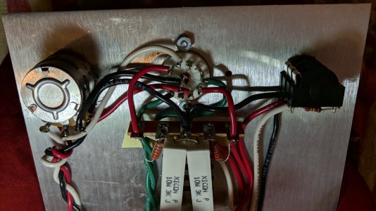

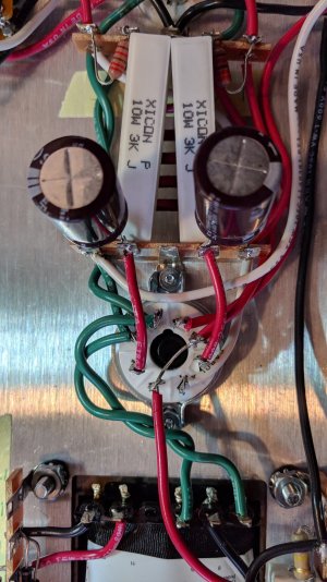

Here are some pictures of the 6080, 8 socket and 20u and 21u.
Does this mean I have to reheat the solders at 20u and 21u? How long should I reheat them for? I just checked them and they were both filled before I resoldered anything.

Just a few seconds should do it, usually not more than 4-5s depending on the overall mass of what you are trying to heat.  It you watch carefully with a bright light, you'll see the solder melt when you apply the iron and you'll also see the melting spread across the solder joint as you heat it.  If you need to add more solder, this is the time.  Then, just remove the iron and let it cool on its own and you should be good to go.

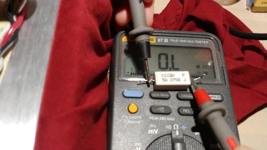

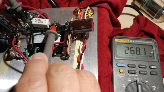

Ok, before I had a chance to solder, my dad who is an electrician checked on the wiring. Everything seemed fine, but we found that the 5w 270ohm resistor by terminal 13 and 14 is open. Could this explain why the amp isn't working properly aside from soldering those two joints?
« Last Edit: January 23, 2020, 05:23:28 PM by tsuid1 »
Deke609
Reply #12 on: January 23, 2020, 05:38:46 PM
... we found that the 5w 270ohm resistor by terminal 13 and 14 is open. Could this explain why the amp isn't working properly aside from soldering those two joints?
Yup. With an open 270R resistor, you'll have no high voltage power supply. You'll want to replace that resistor.

Definitely replace that resistor.  Any 200-300 ohm 5W resistor will do.

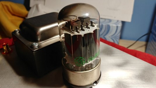

Also do post photos of the 6080 you have in the meantime.
Offline tsuid1
    • Posts: 15
Reply #14 on: January 23, 2020, 07:27:58 PM
Sure no problem. Images are below.
