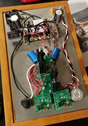

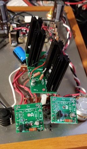

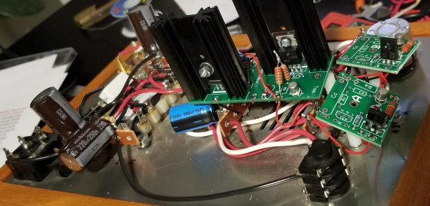

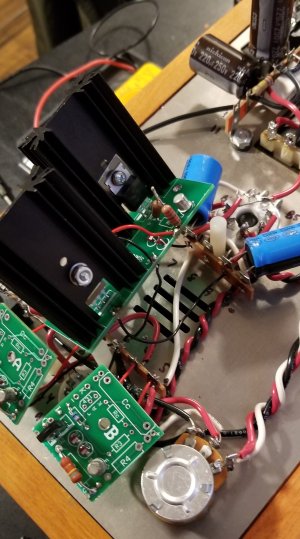

All of my resistors check out with the exception of the one on terminal 12 and 13, is it normal to get sporadic readings on that one? I looked over the tip50, but I don't see that I installed it incorrectly or that the transistor is touching the heatsink. Should I go ahead and reassemble it to be safe? Here are some pictures

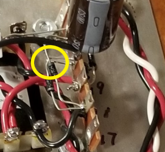

Don't know whether this could relate to the issue you're having, but I'd double check that the circled diode leads in the  attached pic aren't touching or close to touching. It also looks like there's a lead coming from a diode on the opposite side of the terminal strip that needs trimming.

Thanks for the find! Unfortunately, it didn't fix the issue as my LEDs are still out of line.

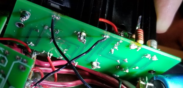

Can you post some pictures of the bottom of the large PC board?
Can you also remove the 6080 but leave the 12AU7, then report the I and O voltages on the smaller PC boards?
