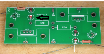

I toke the voltage and i got that:
OA 53v
OB 83v
G 0v
B+ 90v
and i got a led not working on speedball card, see the picture.
What could i do to find the problem?
Do i need to take more valtages?
thank you very much for ur help, i cant solve this alone..

the only led glowing on the other board is the one which was off on my first picture, 3 others are off
i really dont get it, yersteday the OB voltage poped up to 230 today it seems to keep 80.. and the leds keep lighting..
