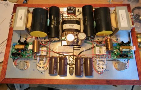

I built my Kaiju at the end of January and have been enjoying it ever since.  After a couple of weeks listening to it in stock form, I replaced the coupling and cathode bypass caps with boutique caps I already had from other abandoned or cannibalized projects.  A little crowded but I like the sound.  Very warm and smooth without sacrificing resolution.
There is a bit of 120 cycle hum, even with the humpots dialed in.  It's low and barely detectable from my listening seat, and I can live with it.  But I wondered if I could lower it by wrapping the 300b heater wires in copper braid, heatshrinking them and connecting one end of the braid to ground.
Is this worth trying?

Reply #1 on: March 01, 2020, 06:52:49 AM
I like that you used blue tack on those big parts, that's helpful.
The DC filament upgrade will lower the noisefloor.  Typically we expect about 5mV or so with an AC heated 300B.  I tested my Kaiju recently at about 120uV, so about a 32dB reduction in noise.
Wrapping the green twisted filament wires in copper braid will do absolutely nothing to lower this noise, and you'll be putting a big conductive piece of metal in the amp that can do weird things if it touches anything.  It would also make the DC filament board a little tougher to install.
