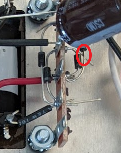

Deke609
It looks like you've fixed this, but I'd double check to be sure. In the first build pic you posted, it looks like the excess lead of a diode was creating a short to ground. I think a short like that would blow fuses for sure. See circled area. Note: the attached is a cropped image so you may need to expand it.
