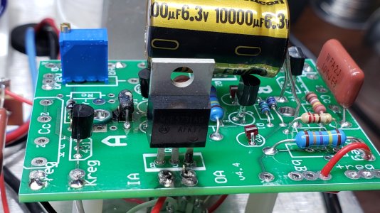

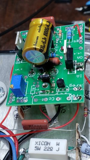

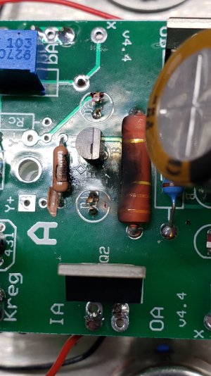

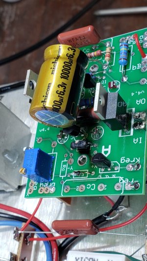

I built both the A and D socket boards for the 5670 tubes driver testing.  During testing the A board's voltages were incorrect.  The D board was perfect, but during the final testing, I accidently touched the positive mm probe to the 5731A transistor to OA.  See pictures for all the damage caused by this error!
Do I need to build another board?  Or just replace the blown resistor, leds, and transistor?

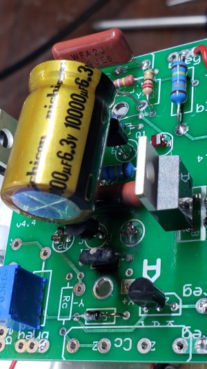

I reviewed my work and went to check in my voltages again.
This time the D board 90R9F blew up.
Any ideas what I did this time?
I checked my work three times for the board and for wiring it up to D.
See pics...

Problems with the tube socket wiring can cause these boards to blow, as can installing any of the zener diodes backwards.
    • Posts: 9790
Reply #10 on: March 24, 2020, 07:54:57 AM
Yup, usually a bad zener string.
